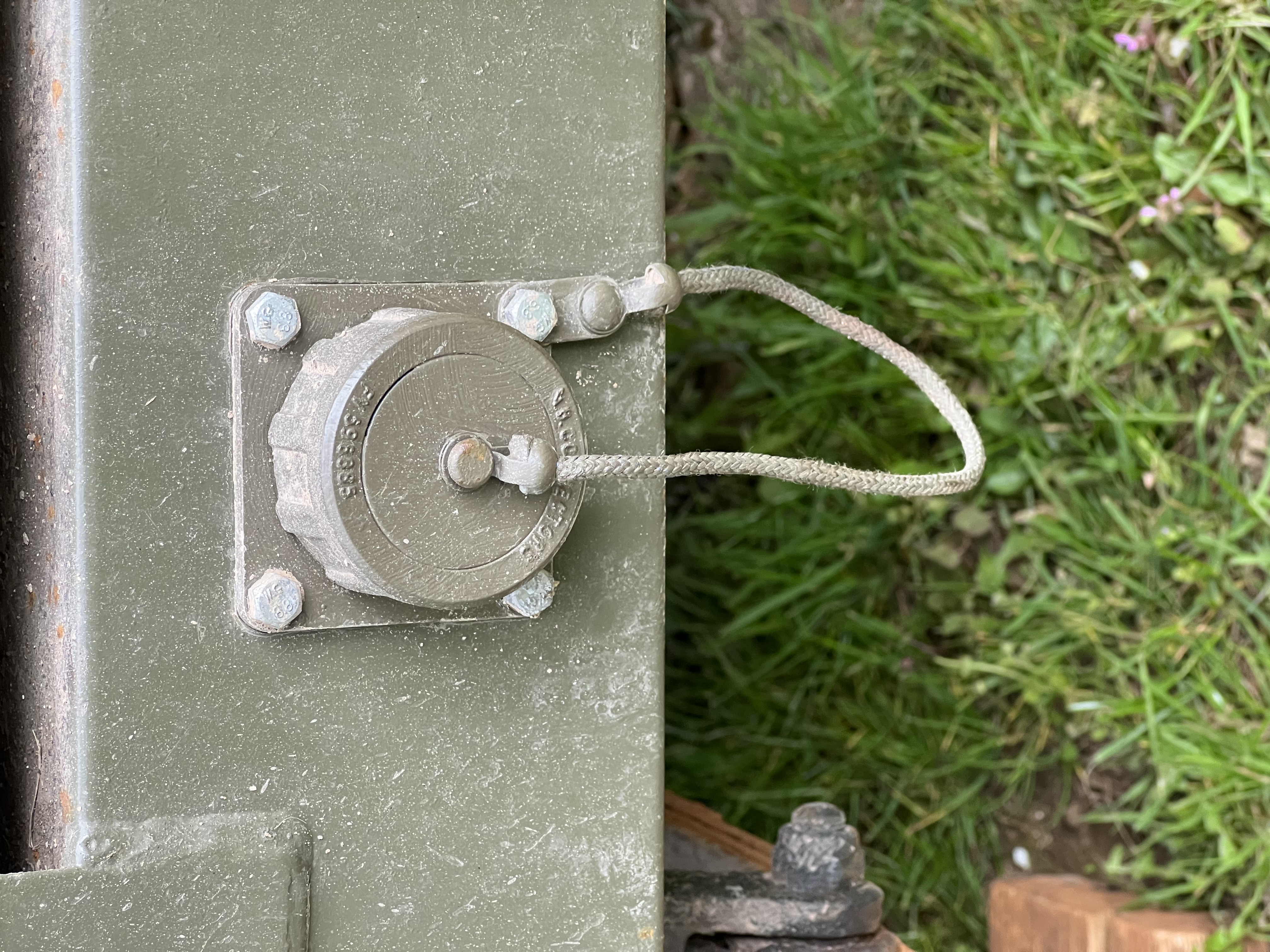

Hi Carlos, here is a photo of the NATO socket on my Series 3 Lightweight.
Basically it is bolted flush to the outside face of the crossmember. There is a sleeve welded between the inner and out faces. The bolts go all the way through to nuts on the inside face.
Your’s is going through the standard crossmember’s power take off hole. The NATO sockyhole is much smaller diameter so does not need a bracket.
In your place I think I would cut a square flat plate to cover the power take off hole. Screw of weld it in place. Then the NATO socket can be mounted in a suitable size hole in the middle of the plate.

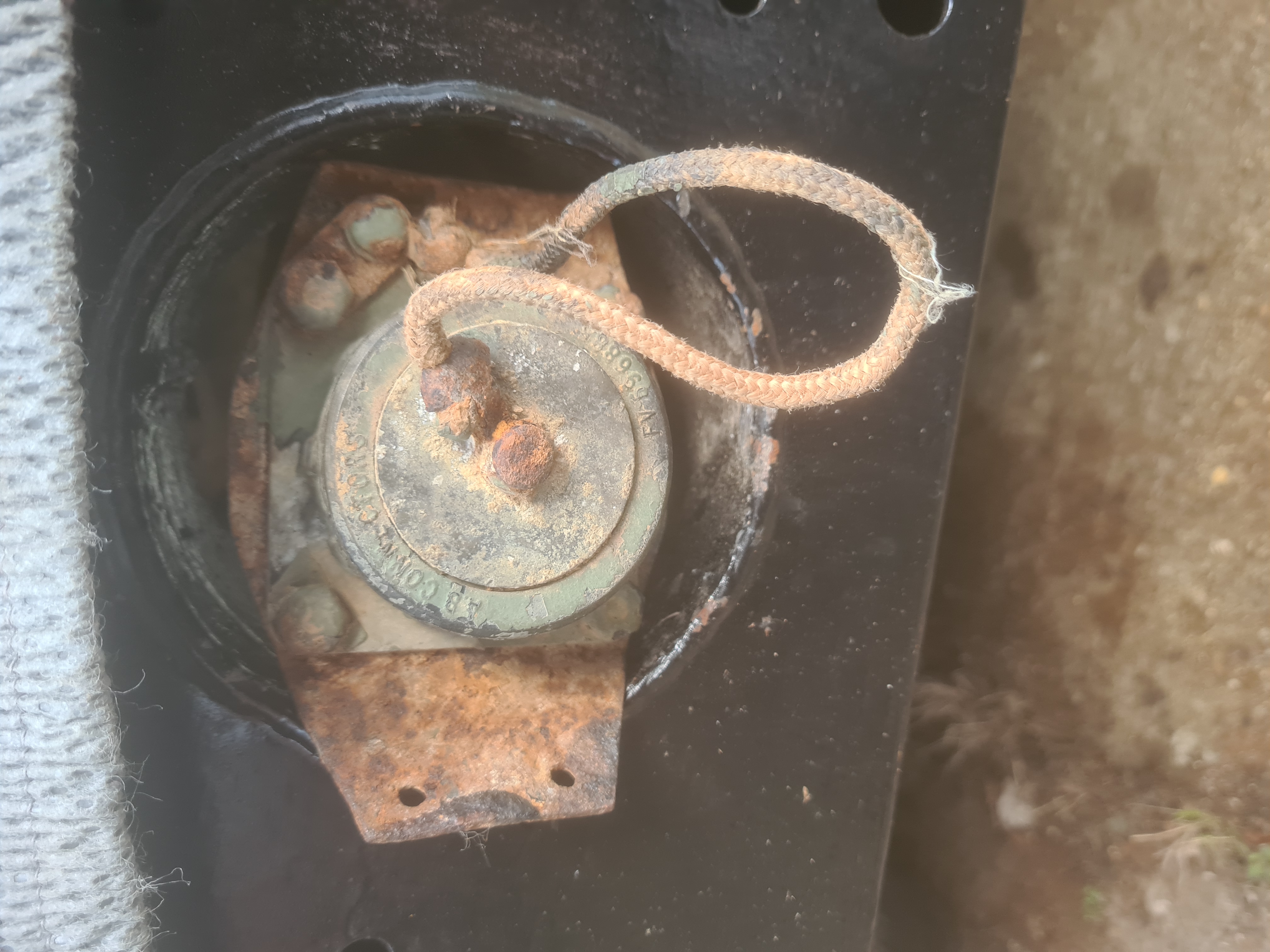

Thanks for the reply, I managed to find a pic of another CL online which shows the bracket, and as I thought it's fitted in the PTO hole.

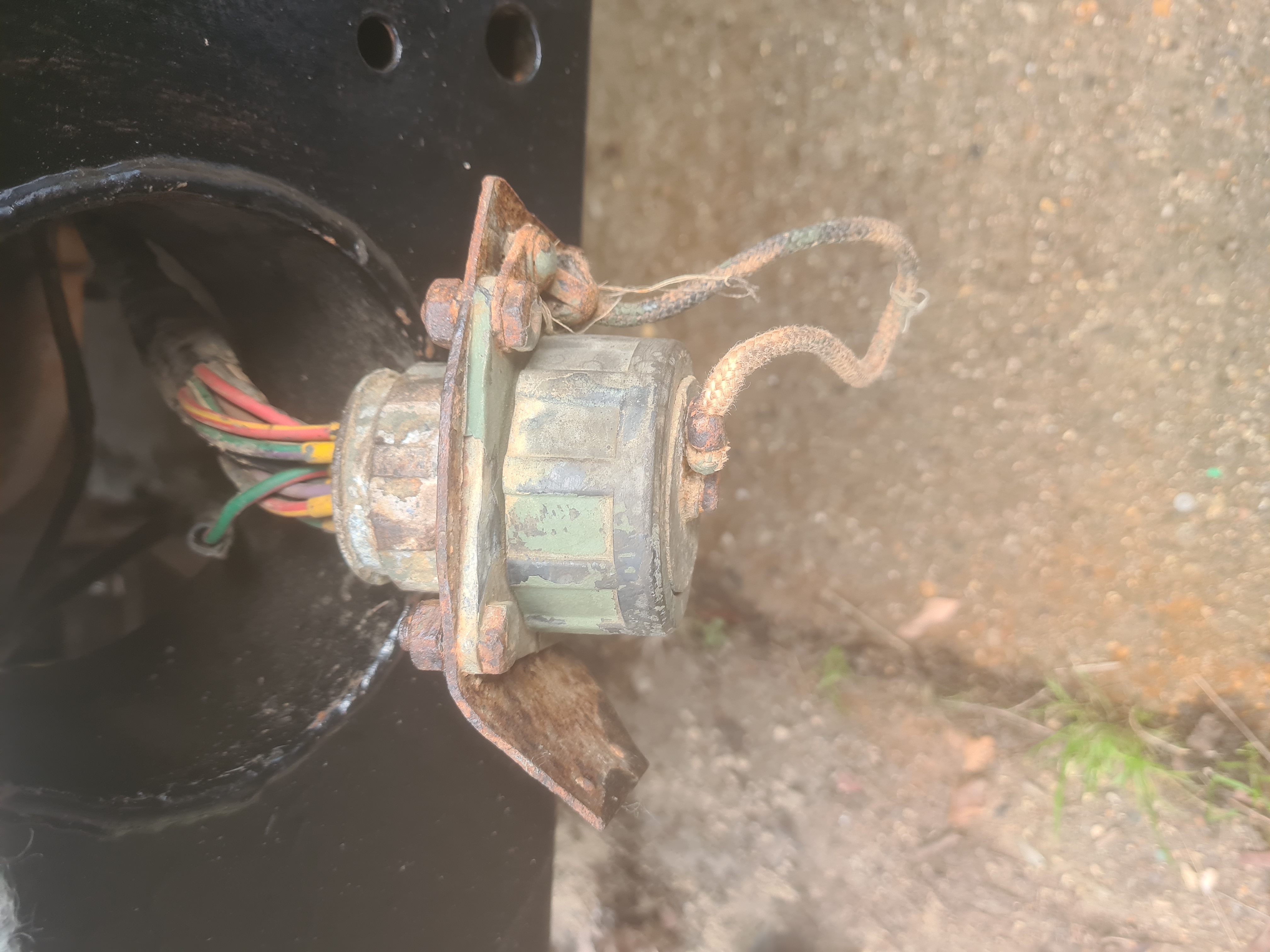

sorted a few weeks back I bought a bracket for military defender.
It is slightly different I had to trim the sides down and it only has two fixings but it will do the job.
