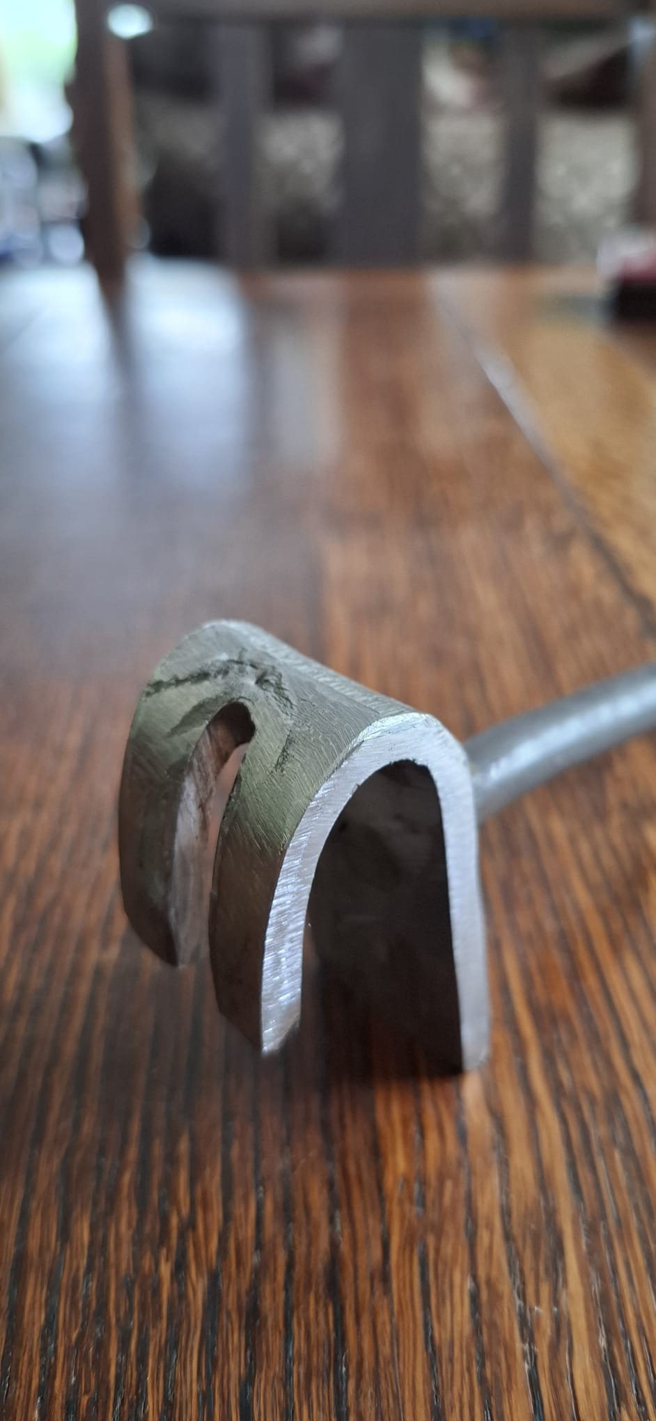

....and here it is. Regards Satan.

Will do, a mate of mine who owns a military 101
Has made me a tool that he uses on his 11” brakes
Reckons it makes it a lot easier
Will be doing them in a fortnights time this weekend and next weekend I very busy with my work, earning to to spend on the landy haha

:-prayer that girling brake tools is a god send also a T handle hook for the springs can make the job a breeze
