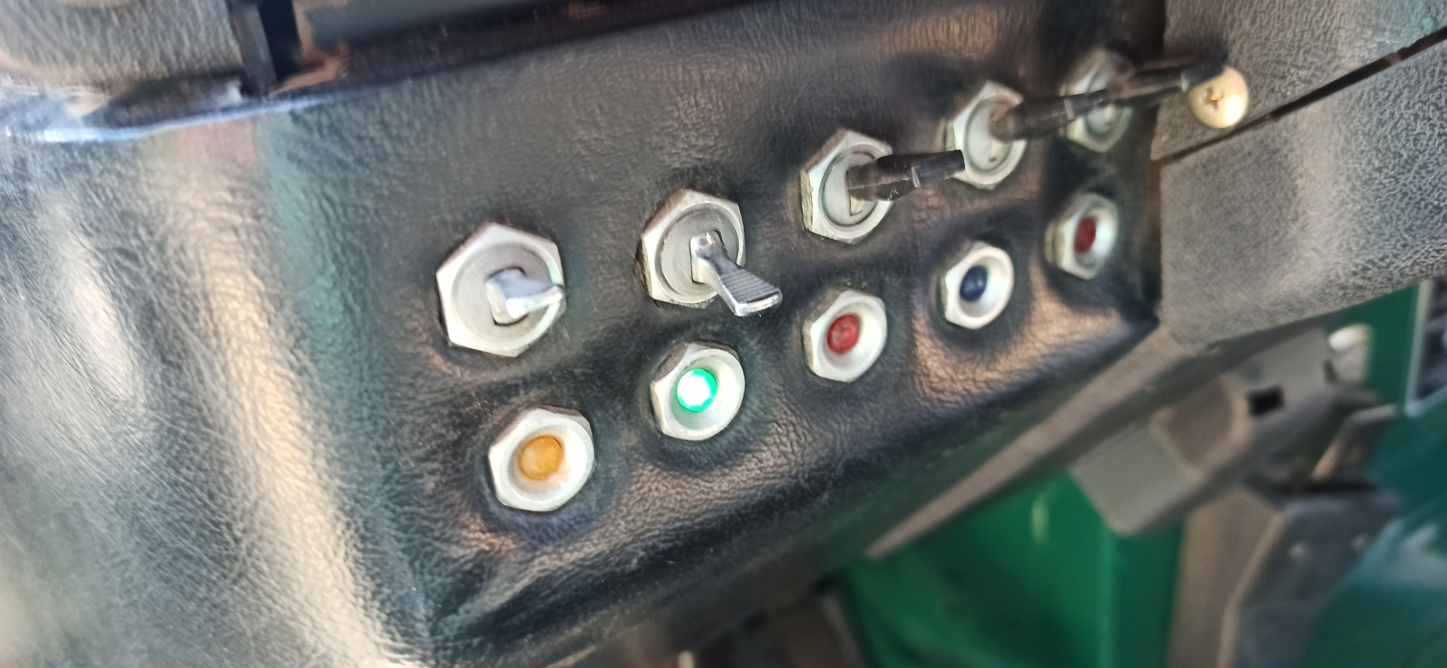

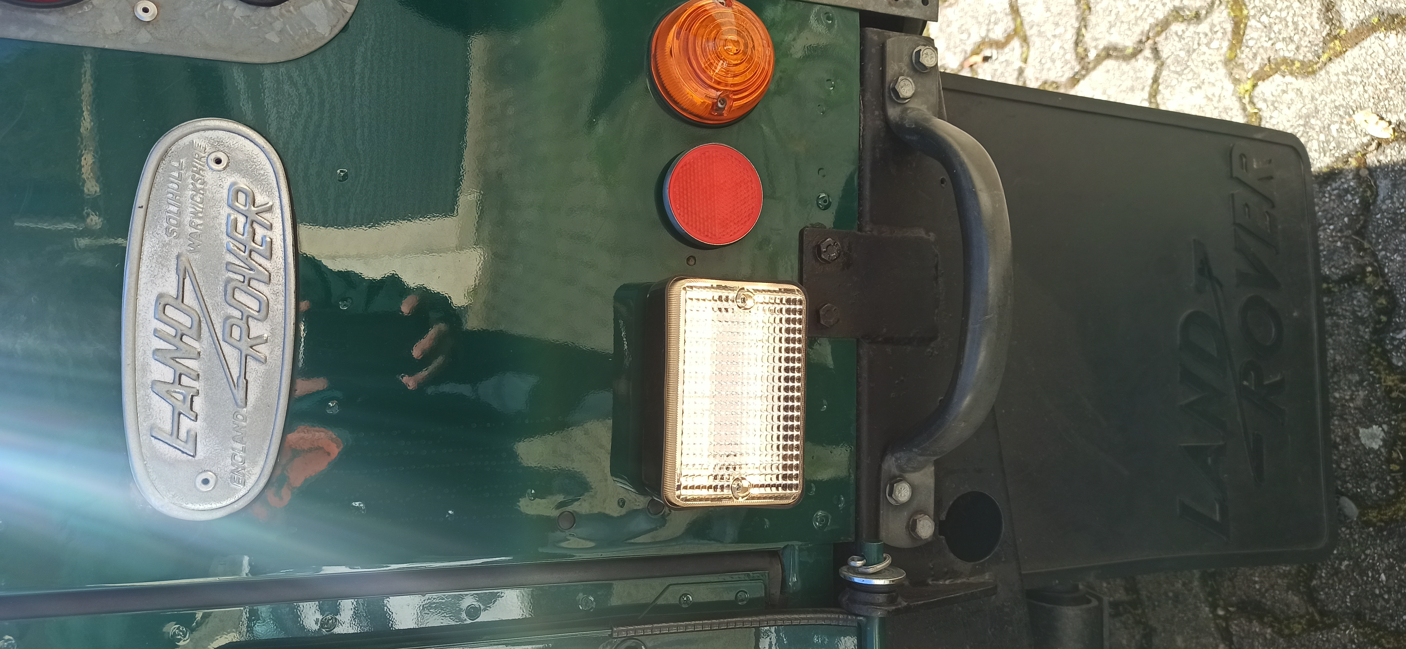

Last addition this weekend, I've fitted a reversing light!
Being (presumably) a demo vehicle from some local LR dealer, it has several (unused) switches on the dashboard.
When activating one of them, I noticed the noise of a relay toward the rear of the car.
I also noticed a couple of dangling cables, and a voltmeter quickly confirmed one of switches would give 12V on one of those!
So I ordered a revering light (the period correct square one, not the round one from later Defenders) and installed it this weekend.
Very happy with the result! :-thumbsup :D

o4dn wrote: Sun Mar 29, 2026 12:54 pm Last addition this weekend, I've fitted a reversing light!
You can get a switch for the gear lever so the reversing light automatically comes on when reverse is selected. I think it's the same switch as the plastic brake light switch on single brake circuit Series 3's.
Posted: Mon Mar 30, 2026 6:01 am
by o4dn
Neil Bymouth wrote: Sun Mar 29, 2026 9:25 pm You can get a switch for the gear lever so the reversing light automatically comes on when reverse is selected. I think it's the same switch as the plastic brake light switch on single brake circuit Series 3's.
Not really, I have fitted a slick shift last year, the turret is different from the original one on the S3 (same as the later ones for the R380).
But a switch on the dashboard works fine for me, also because I have a number of unused switches!
