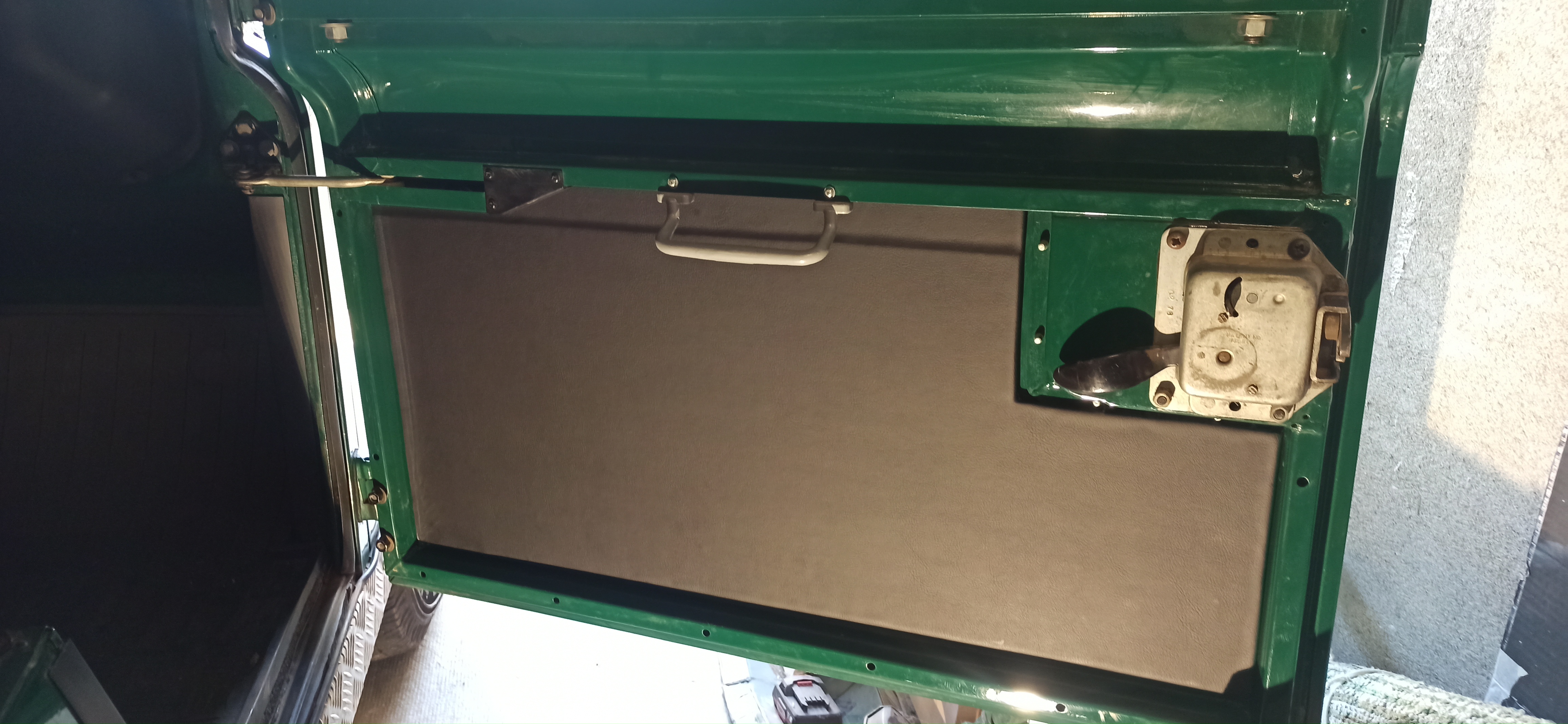

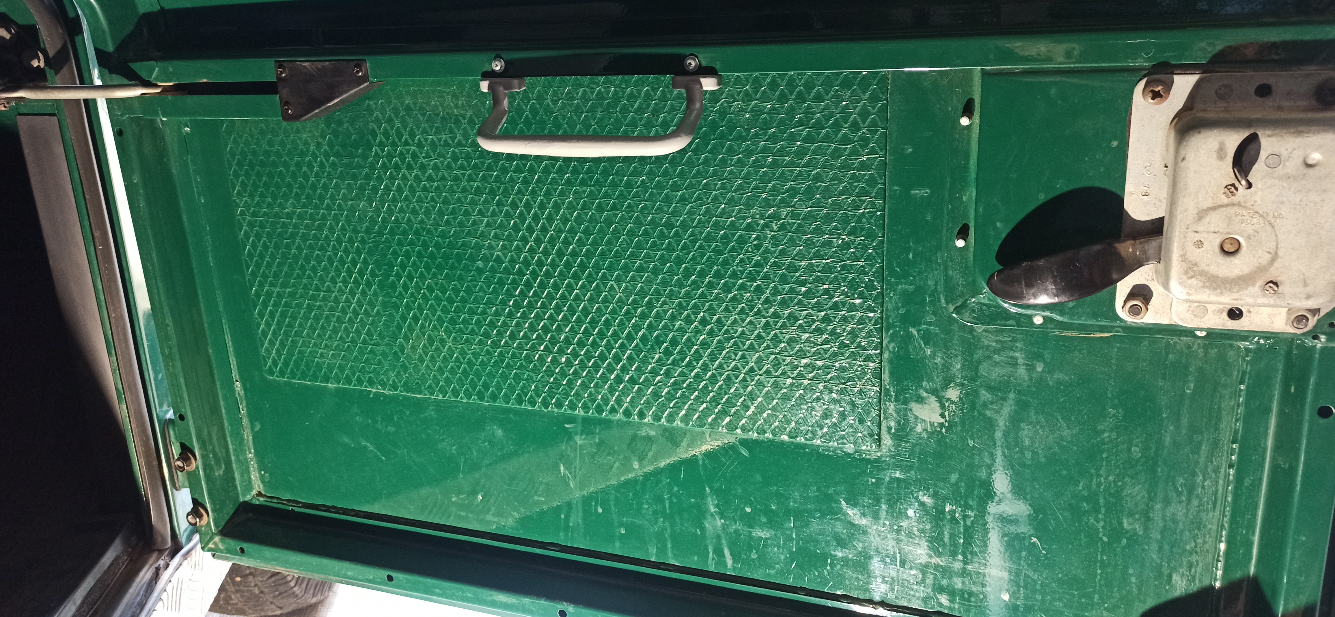

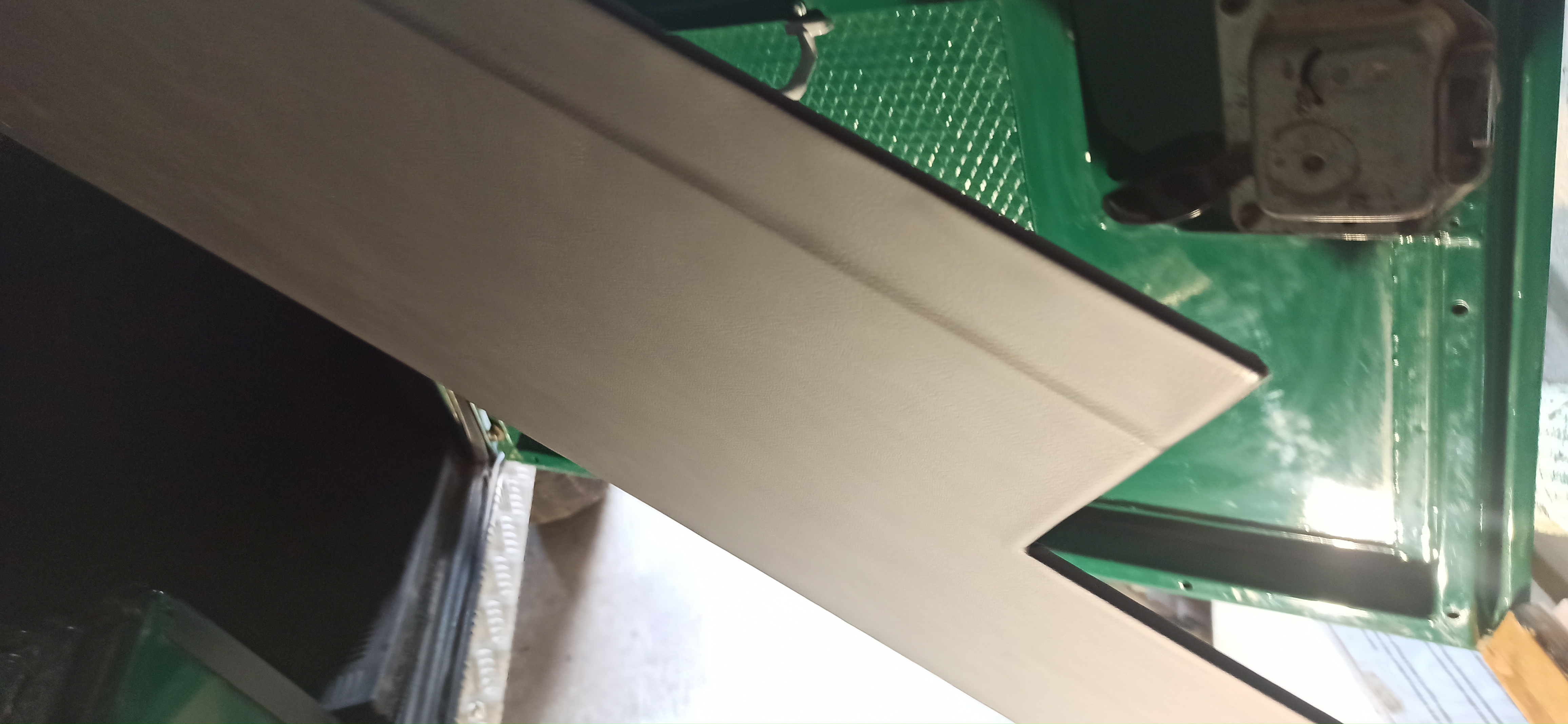

As I had some marine grade vinyl left from the dashboard, I decided to give a try at doing my own poor man's door cards...
My S3 being a base model, it has bare doors inside:
So I made my own door cards, reusing the leftover of vinyl I had, and some 3 mm MDF that I purchased from my local B&Q store:
And used some strong double sided adhesive tape to hold it into place:
Very pleased with the result, not only it looks quite nice IMHO, but the doors now makes a different sound when closing!

Good idea and a neat job. I've got Defender doors on my Series 3 so door cards already there.
