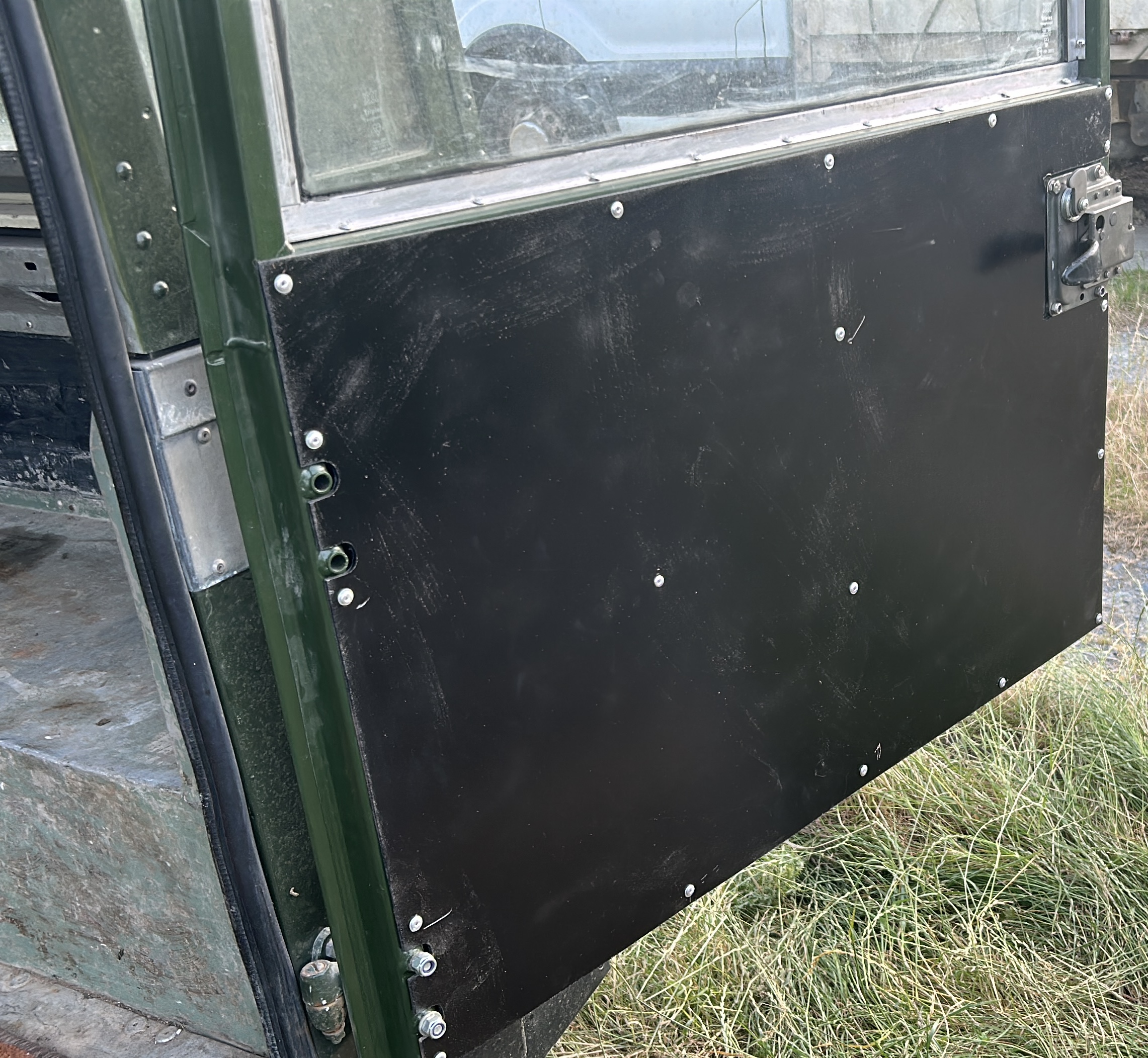

Just pop riveted the back door card I made for the new rear door.
Nice and cool evening to be working on it
Just a bit of touch up black paint to do then finished.
- 1FB5D3BA-79B2-4C10-BF15-0878B7464297.jpeg (1.4 MiB) Viewed 22863 times
Before fitting I drilled a few holes through the top of the bottom box section and sprayed waxoyl inside.
The original door was totally rotten all along the bottom box section.
So hopefully this will help it last for many years to come.

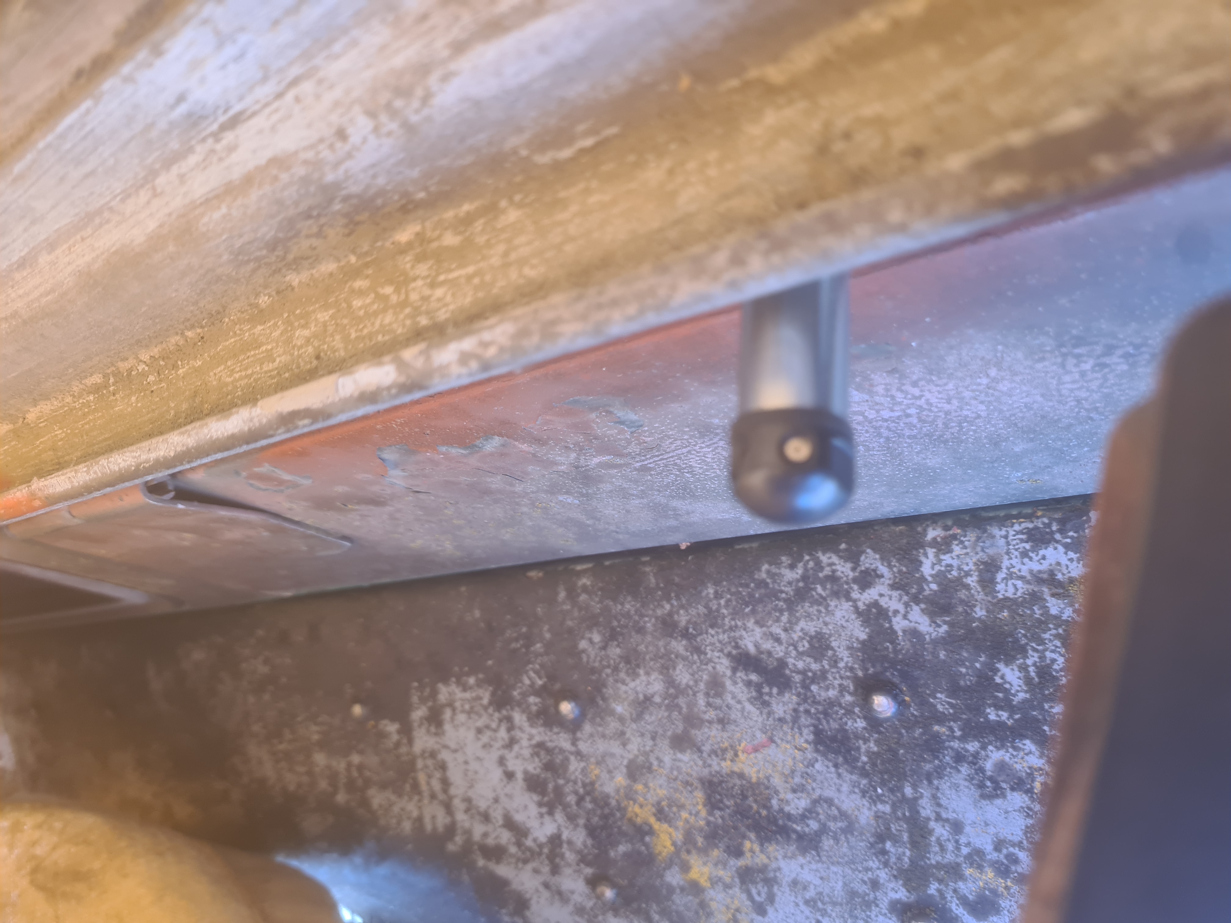

Fitted a pair of stainless steel washer jets courtesy of Emberton, Great job if your a glutton for punishment
