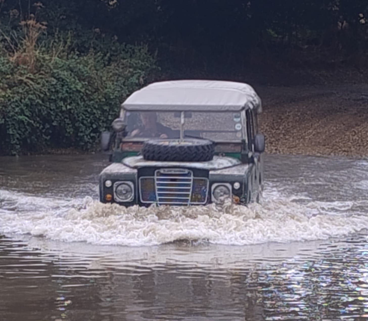

Spent a day green Laning with Hert and Upper Great Ouse
Great day with Great people
