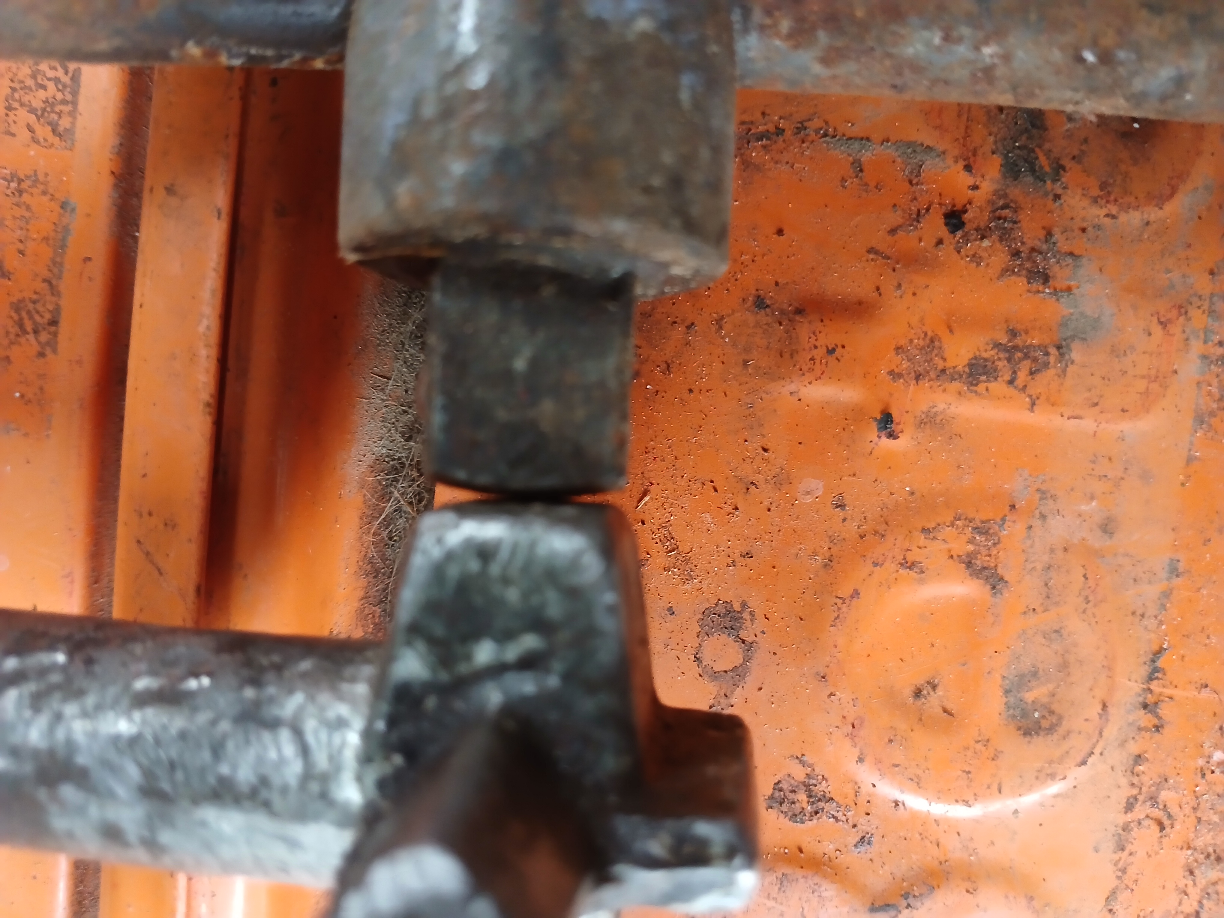

I hope there's an image attached.
If so, it shows the largest square end of my multitool compared with a 1/2 inch square drive. The square on the multitool widens from.the tip so I reckon that would fit your plug.

Re: Filler plug
I can't find anything on line remotely like it. I've had it for ages and can't remember when or where I bought it. The other end has a square hole which is a different size each side for removing square headed filler plugs.
I'd guess that the size of square section you need is approx 17/32 of an inch or about 13/13.5 mm. As you can see from the photo there's a very small difference and that's why your 1/2 inch drive fits loosely but sufficiently to undo and fo up the plug. All my filler plugs are the raised square head tupe.

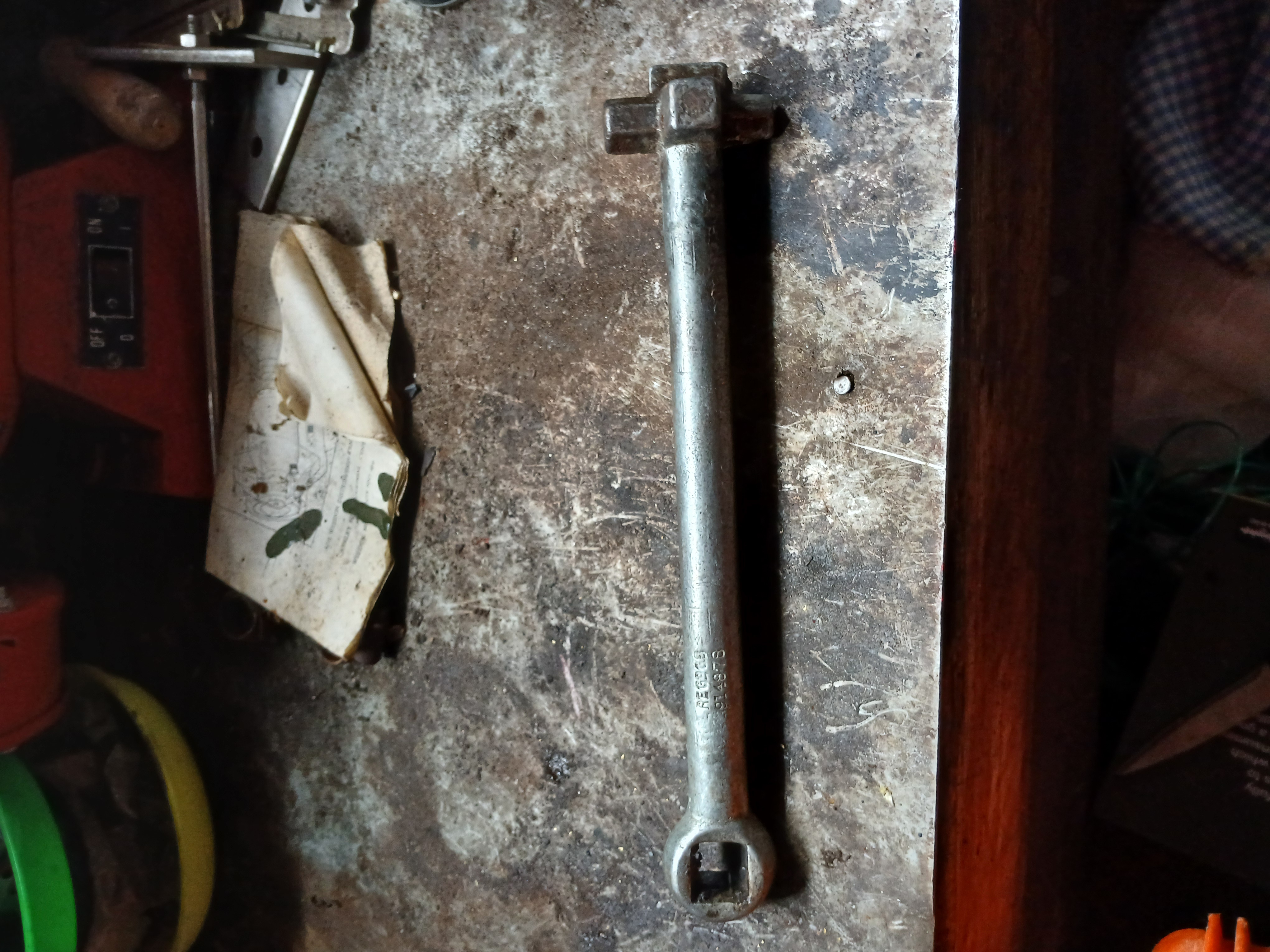

Re: Filler plug
This is what my drain/filler plug multitool looks like. I suppose multitool is a misnomer, more like universal.

Re: Filler plug
I looked for on line "Universal Land Rover Drain /Filler Plug Tool." Artificial Idocy said there's no such thing so what have I got?
